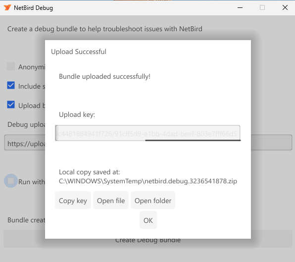

Debug bundle uploads
Since version 0.43.1, you can share debug bundle with the NetBird development team without local administrative
privileges
by using the --upload-bundle (-U) flag.
It will securely generate and upload the debug bundle to our servers for access by the NetBird development team. See
examples below:
Run debug for a specific time and upload the bundle:
netbird debug for 1m --system-info --upload-bundle
To generate a bundle without restarting the client and then uploading:
netbird debug bundle --system-info --upload-bundle
This will output an Upload file key, which is effectively a random filename in our internal storage system
and can be safely shared with us through public channels such as GitHub Issues, Slack, or Discord.
Uploading the bundle does not remove the local ZIP from the temporary directory.
Local file:
/tmp/netbird.debug.2611377582.zip
Upload file key:
1234567890ab27fb37c88b3b4be7011e22aa2e5ca6f38ffa9c4481884941f726/12345678-90ab-cdef-1234-567890abcdef

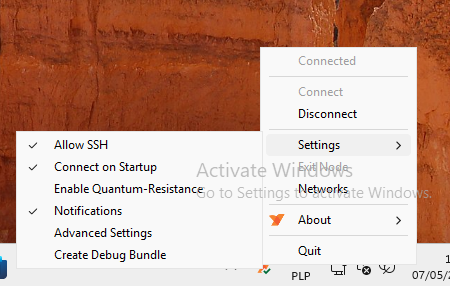

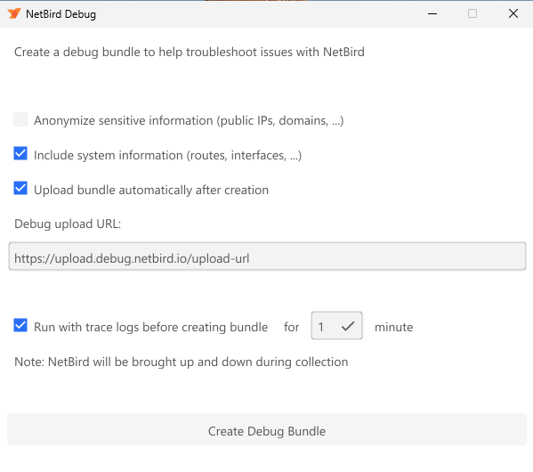

The desktop app can create and optionally upload a debug bundle without using the CLI. Open Settings → Troubleshoot.
Choose the data and capture behavior that fits the issue:
- Anonymize sensitive data masks IP addresses, domains, interface names, and peer identifiers where supported.
- Include system information adds routes, interfaces, resolver state, and firewall information.
- Upload Bundle to NetBird Servers uploads the completed archive to NetBird's fixed debug-bundle service. Disable it to keep the bundle local.
- Enable trace logging temporarily raises the client log level while the bundle is collected.
- Restart connection cycles the NetBird connection during collection. Disable it when reconnecting makes the issue disappear.
- Capture packets adds a packet capture while collecting new logs. Packet captures are excluded from anonymized bundles because they contain raw packets.
- Capture duration accepts 1–30 minutes.
Click Create debug bundle. You can cancel while logs are being collected. When the operation finishes:
- If Upload Bundle to NetBird Servers is enabled, the app displays an upload key. Copy the key and share it with the NetBird team.
- If upload is disabled, the app displays the ZIP location and an Open Folder button.
In both cases, the ZIP is stored locally in the platform's temporary directory listed above.
If you kept the bundle local, attach the ZIP through the support channel you are using.

You can trigger remote debug bundles directly from the NetBird Dashboard without requiring CLI access.
To generate a remote debug bundle:
- Navigate to Peers in the dashboard
- Click on the peer you want to troubleshoot
- Click the Run Remote Job button (the peer must be online and connected)
- Select Debug Bundle from the dropdown menu
- Configure the debug bundle options:
- Log File Count: Number of log files to include (1-50, default: 10)
- Enable Bundle Duration (optional): Collect logs for a specific time period (1-5 minutes) before generating the bundle
- Anonymize Log Data: Remove sensitive information like IP addresses and domains
- Click Create Debug Bundle
Viewing job status and results:
Once triggered, the job appears in the Remote Jobs section on the peer details page. The table shows:
- Type: The job type (Debug Bundle)
- Status: Pending (yellow), Completed (green), or Failed (red)
- Created/Updated: Timestamps for job lifecycle
- Output: Once completed, displays the upload key that you can copy and share with NetBird support
The upload key is automatically copyable by clicking on it. Share this key through GitHub Issues, Slack, Discord, or support channels.
