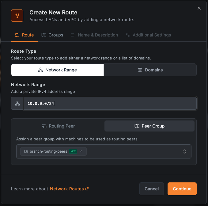

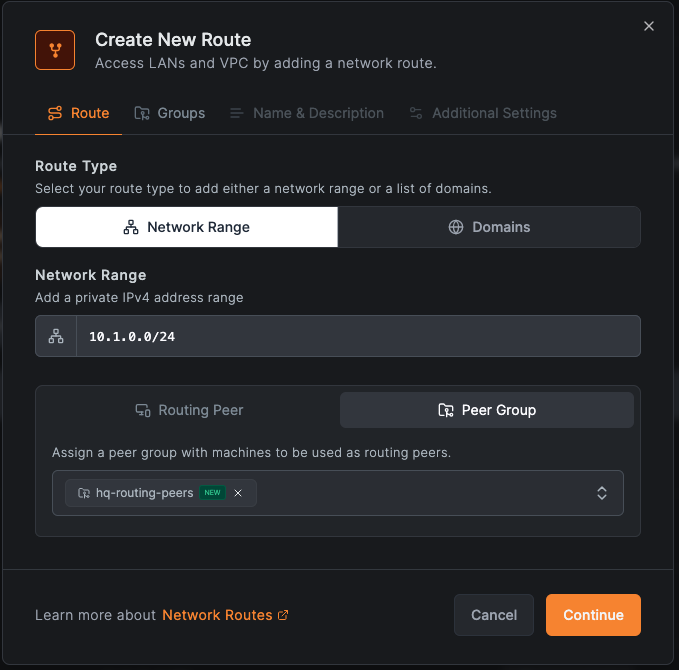

Step 3: Create network routes
Add one route per site under Network Routing → Routes → Add Route:
Site A:
- Network range:
10.0.0.0/24 - Routing Peer: the
site-a-routersgroup (or a specific peer) - Distribution Groups:
site-b-routers - Access Control Groups:
site-a-routers(optional — see Access Control) - Network Identifier:
site-a - Enable Masquerade under Additional Settings (recommended — see Advanced Configuration for the disabled case)
Site B: swap the values — 10.1.0.0/24, site-b-routers as routing peer, site-a-routers in distribution.

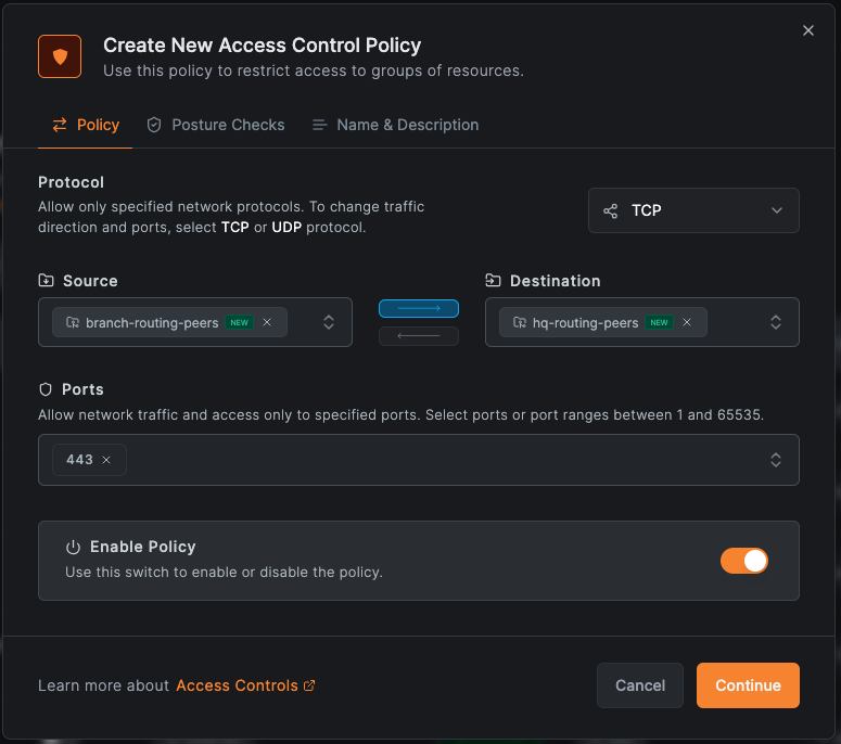

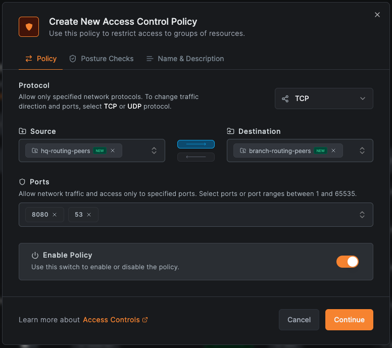

Step 4: Create bidirectional policies
Site-to-Site requires two policies — one for each direction:
site-a-routers → site-b-routers (All protocols)
site-b-routers → site-a-routers (All protocols)
Tighten by protocol/port if needed.
