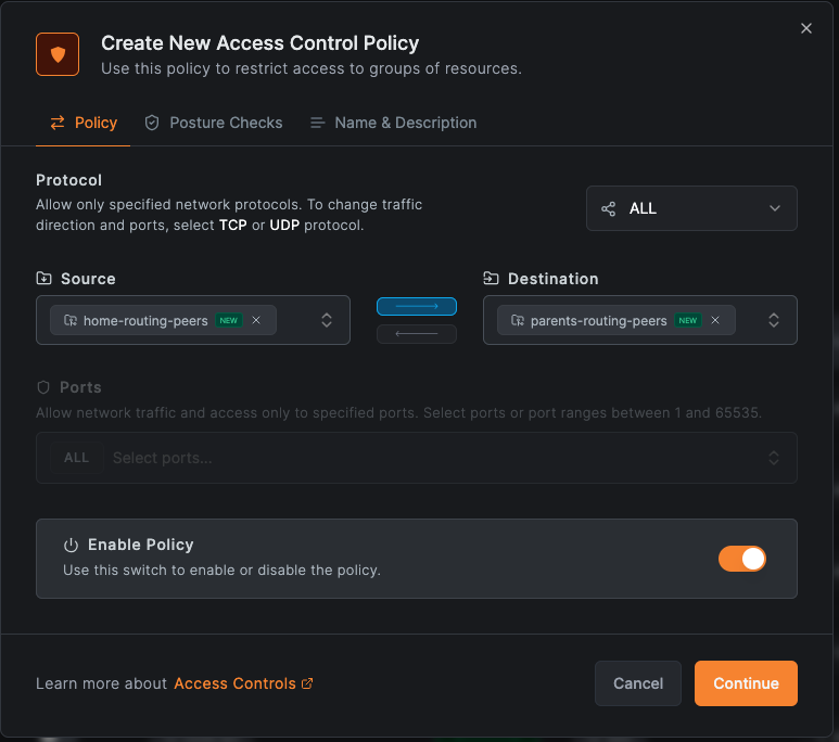

Step 4: Create bidirectional policies
Site-to-Site requires two policies — one for each direction:
site-a-routers → site-b-routers (All protocols)
site-b-routers → site-a-routers (All protocols)
Tighten by protocol/port if needed.
