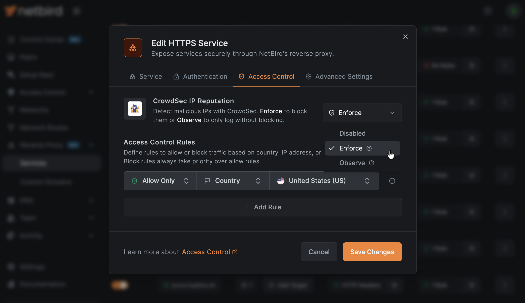

- Per-service enforcement. Each reverse proxy service can be set to
off,enforce, orobserve. The proxy consults the local cache on every incoming connection, so checks are fast and do not add a network round trip.
The proxy advertises a supports_crowdsec capability to the management plane, which is how the dashboard decides whether to show the CrowdSec option in the Access Control tab. If CrowdSec is not configured on the proxy cluster, the option is hidden.

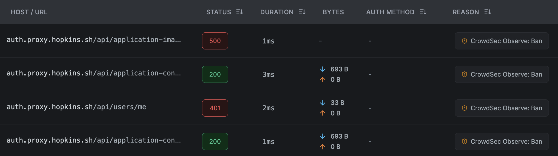

Reviewing observe-mode verdicts
Observe-mode verdicts are recorded in the NetBird proxy access logs, not in the CrowdSec Console. When a service is in observe mode and CrowdSec flags an IP, the connection is allowed and the verdict is attached to the log entry as metadata (crowdsec_mode and crowdsec_verdict), with no deny reason contributed by CrowdSec. In the dashboard's reverse proxy event log, these entries render with an observe-mode badge on the reason cell and show the decision type (ban, captcha, throttle, unavailable) so you can audit what would have been blocked before switching the service to enforce. The CrowdSec Console shows the aggregate view of community decisions and scenarios but does not know which of your proxy requests the bouncer was consulted on.

Configuring services
Once CrowdSec is enabled on the proxy, the CrowdSec IP Reputation dropdown appears in the Access Control tab of each reverse proxy service. Set it to Enforce or Observe per service. See reverse proxy authentication for configuration steps and access logs for the verdict fields that appear in event logs.

With a service set to enforce, the connection from <your-ip> is rejected with a 403 within roughly 10 seconds (the bouncer poll interval), and the access log entry carries crowdsec_ban in its auth_method_used and metadata.crowdsec_verdict fields. With a service set to observe, the connection succeeds and the verdict appears on the event entry with an observe-mode badge. The decision expires automatically after 5 minutes, or you can remove it earlier with cscli decisions delete --ip <your-ip>.
