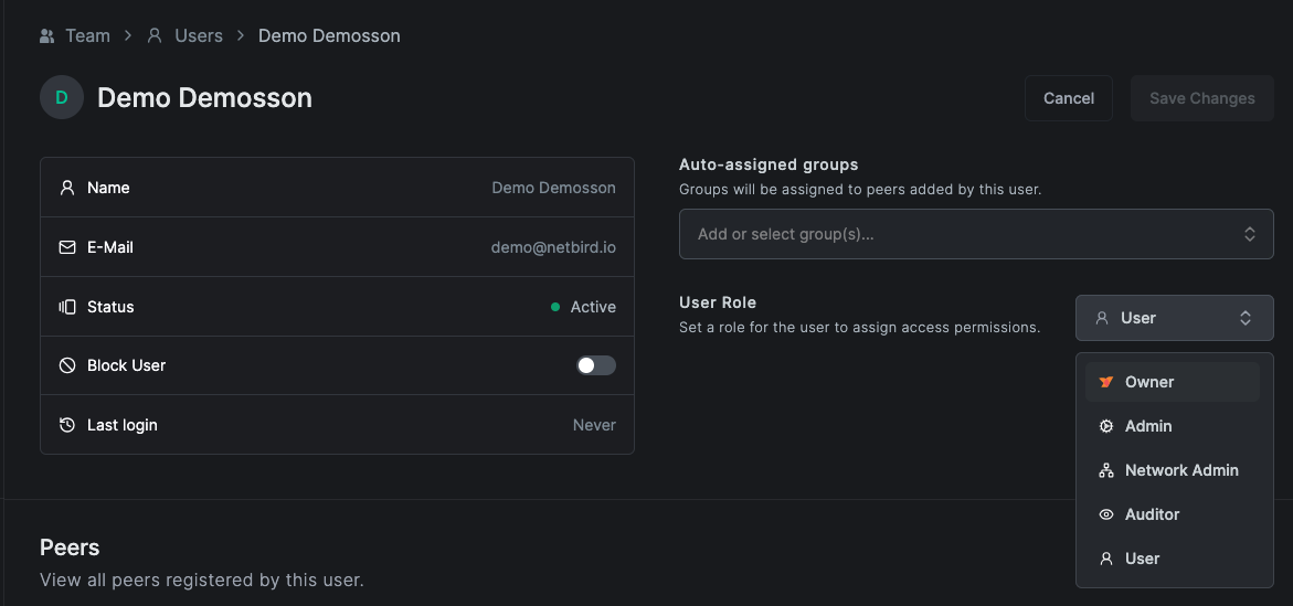

- Log out and log in with your new admin account via the external IdP. NetBird will notify you that the user requires approval.
- Log back in as your original NetBird-local admin and navigate to Users. You should see the new IdP user pending approval:
- Approve the request, click on the user, select Owner as the role, confirm the ownership transfer, and save.
- Verify you can log in via the external IdP with full owner access.
Complete all prerequisite steps before disabling local authentication. If you disable local login without first promoting an external IdP user to Owner, you will lose administrative access to your instance.
