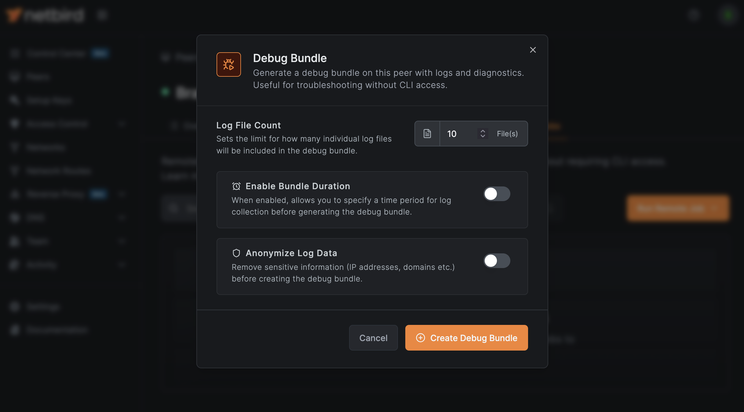

Using the Dashboard
Creating a Remote Job
- Navigate to Peers in the Dashboard
- Click on the peer you want to target
- Click the Run Remote Job dropdown button
- Select Debug Bundle
- Configure the job parameters:
- Set the Log File Count (how many log files to include)
- Optionally enable Bundle Duration to collect logs over a time window before generating the bundle
- Toggle Anonymize Log Data to strip sensitive information
- Click Create Debug Bundle
The Run Remote Job button is disabled when the peer is offline, when the peer has not opted into remote jobs, or when you lack the required permissions.

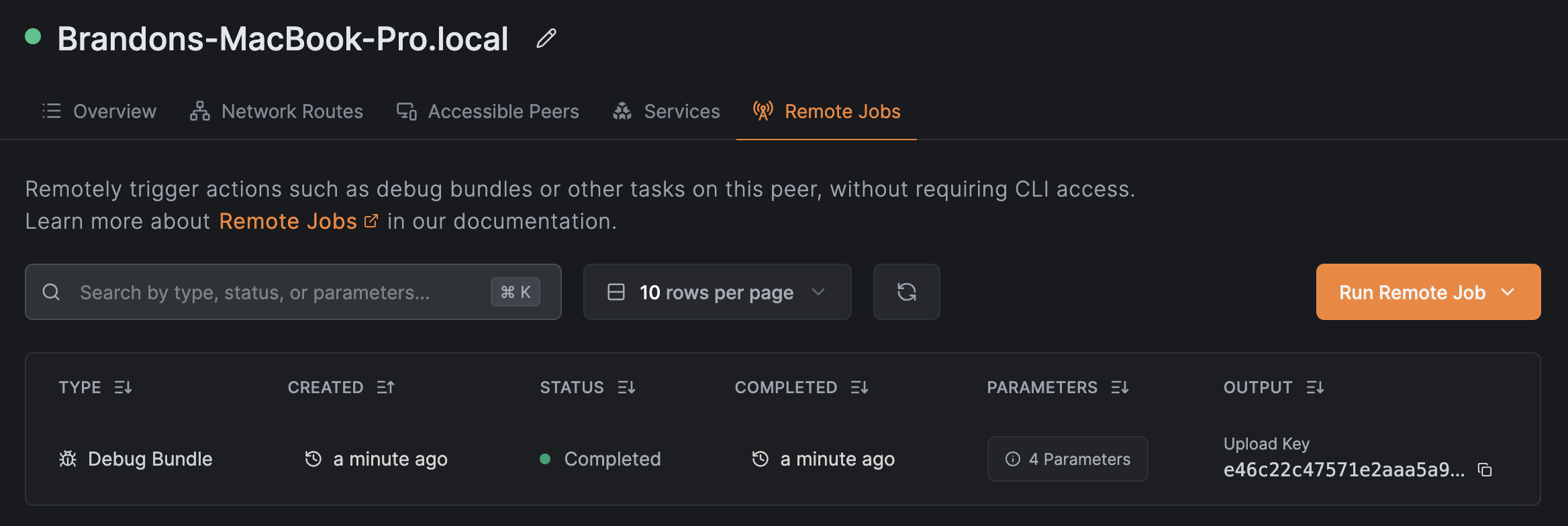

Viewing Job History
The Remote Jobs tab on the peer detail page shows all jobs for that peer, sorted by creation time (newest first). The table displays:
- Type - The job type (e.g., Debug Bundle)
- Status - Color-coded status badge (yellow for pending, green for succeeded, red for failed)
- Created / Completed - Timestamps for the job lifecycle
- Parameters - Hover to view the full parameter configuration
- Output - On success, the result (e.g., upload key with copy button). On failure, the error reason.
