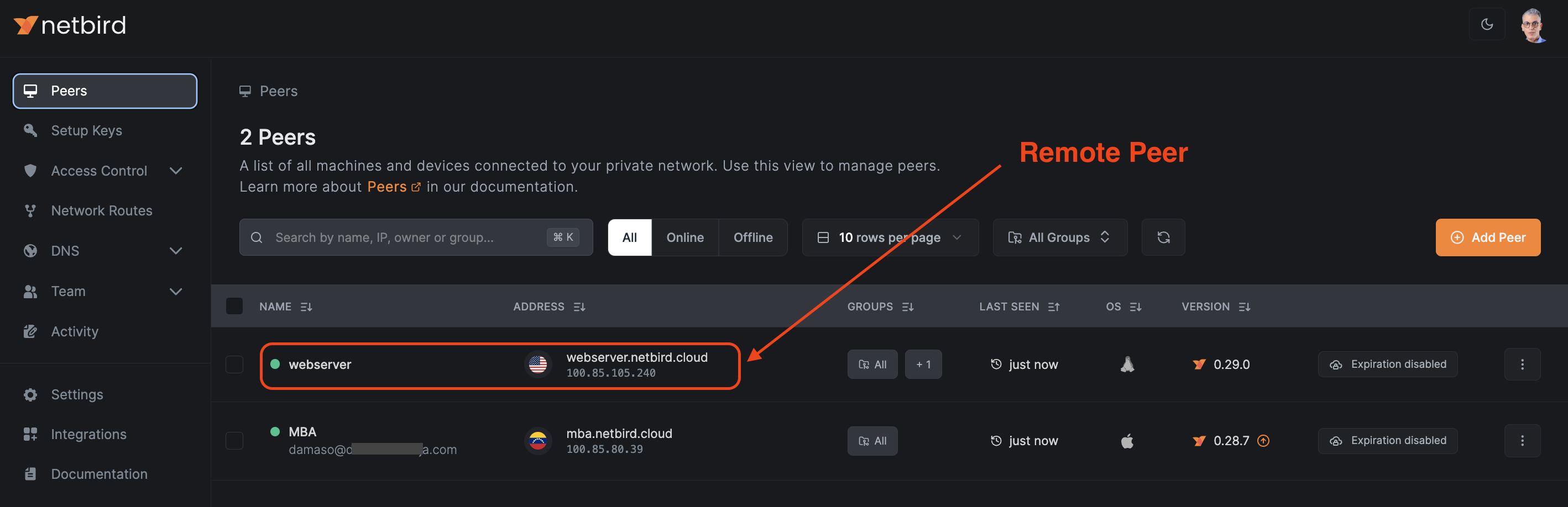

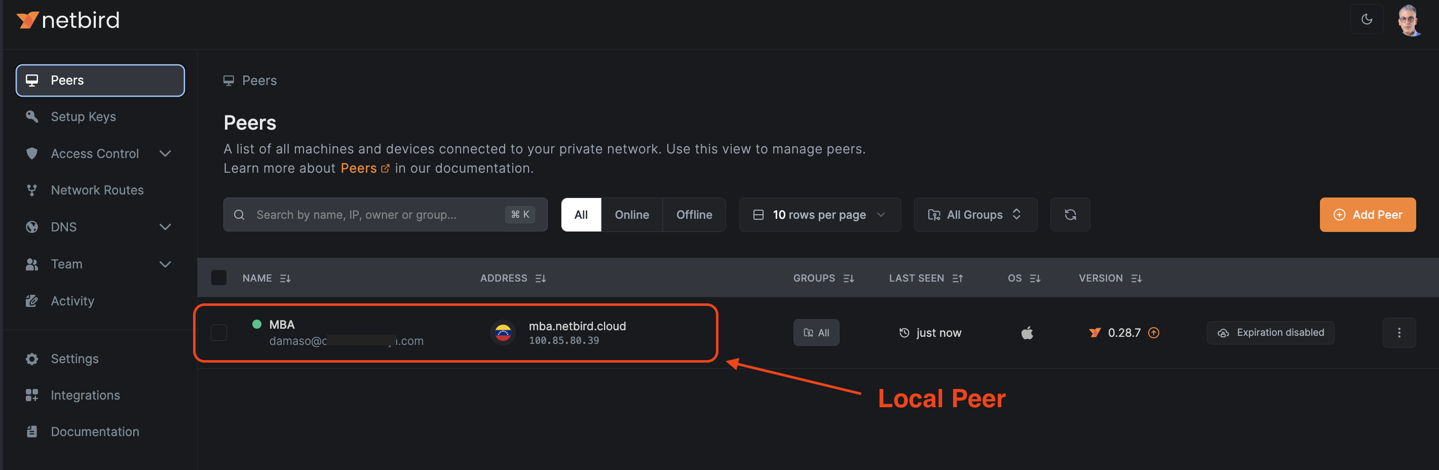

1. Installing NetBird on the Remote Server
Login to NetBird and navigate to PeersUser Devices. Ensure you see your local peer connected.
NetBird Local Peer

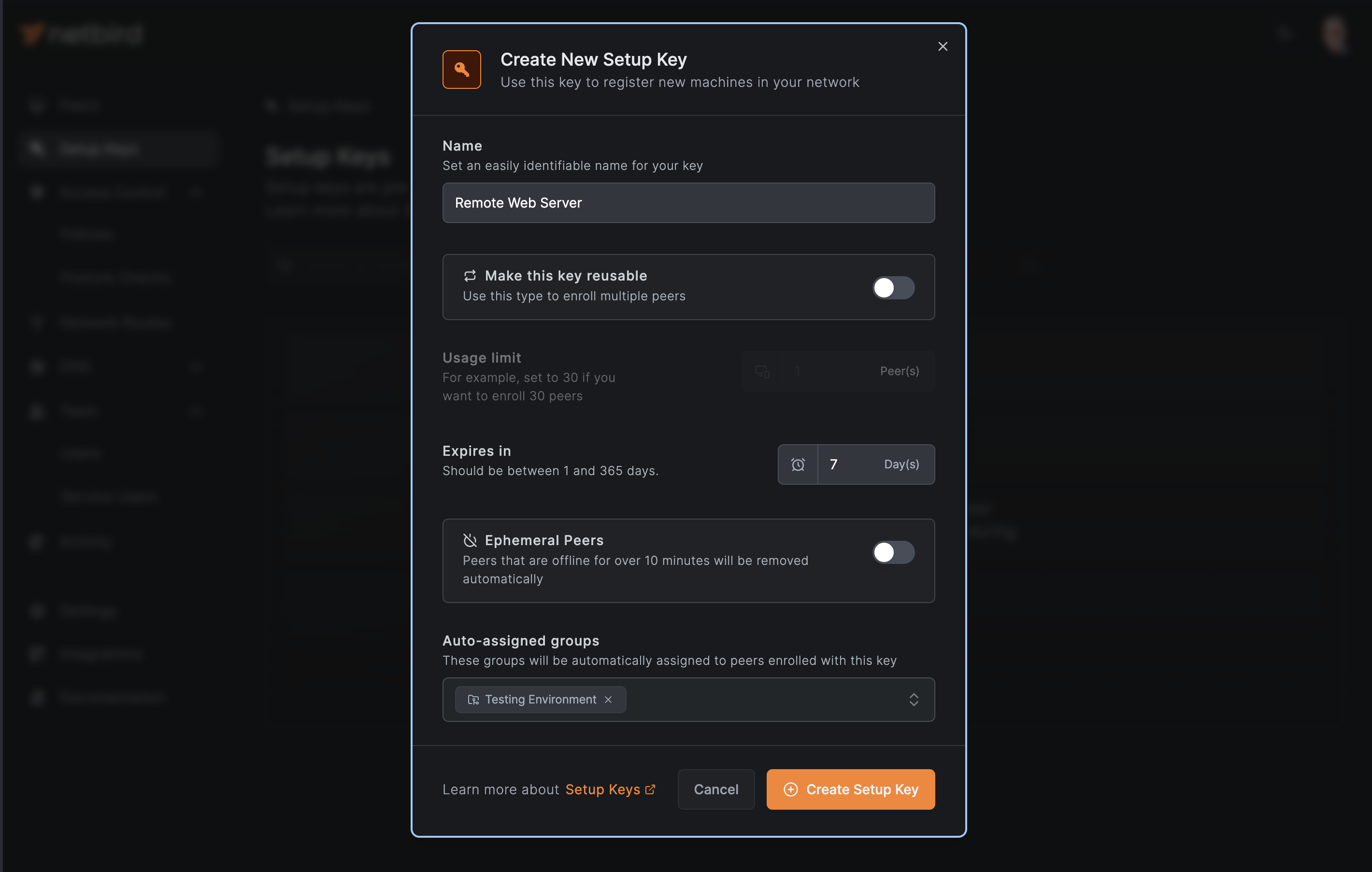

To add your remote web server to NetBird's peer network, first you need to generate a setup key:
  • Navigate to SettingsSetup Keys in the left menu
  • Click Create Setup Key
  • Configure the key by assigning it a descriptive name (e.g., "Remote Web Server"), setting an expiration date, and defining auto-assigned groups (if required). Read the documentation for detailed setup key configuration.
  • Copy the generated key to a secure location as you'll need it shortly
NetBird Creating Setup Key

Now, go back to NetBird's Peers view and ensure your remote web server is connected.
NetBird Peers Network

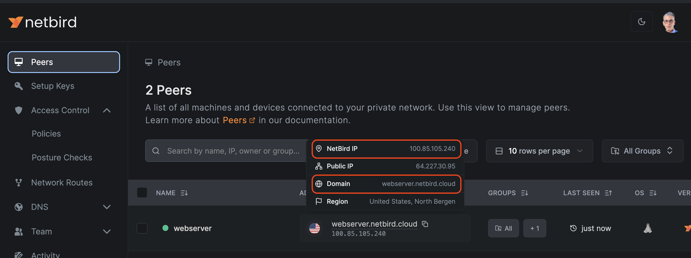

While you're there, take note of the IP addresses listed on the left. Use the quick copy buttons to get NetBird IP-Address and Domain Name. Alternatively, you can hover over the peer in the peers' list and copy the IP addresses as shown below:
NetBird IP Addresses

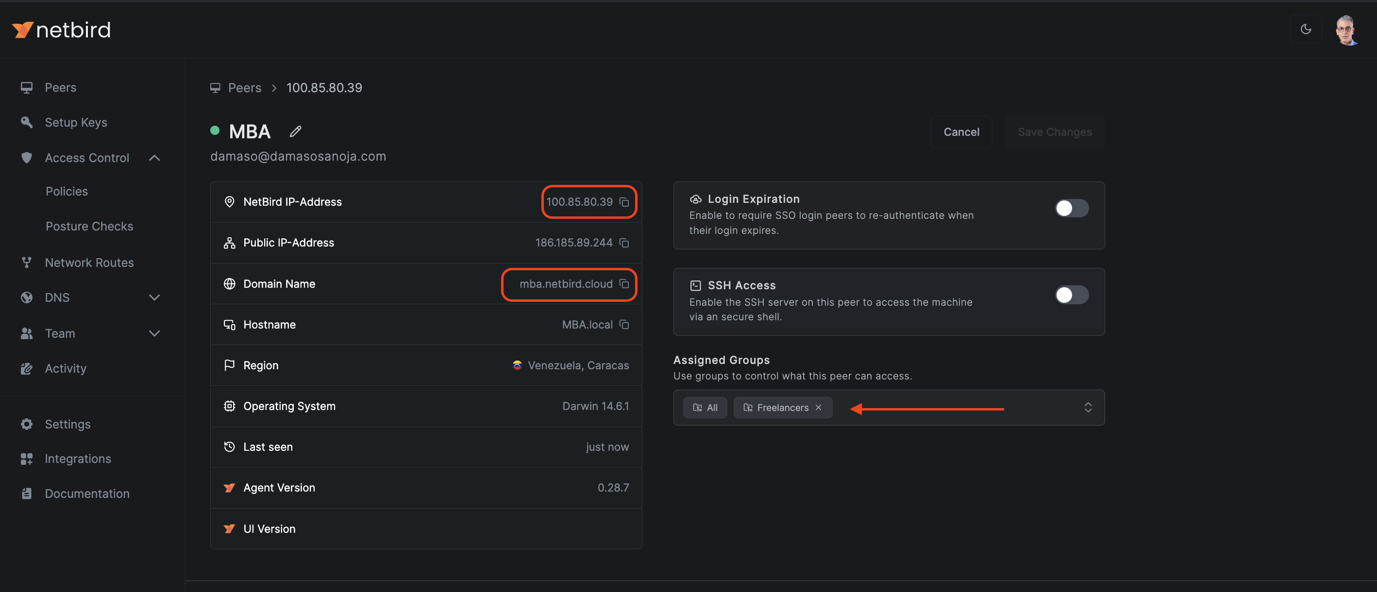

With your remote server configured and the corresponding access policy enabled, the final step is to assign users to the appropriate group:
  • Locate your user in the peers' list and click on it
  • Find the Assigned Groups field and select Freelancers from the dropdown list.
NetBird Local User Peer

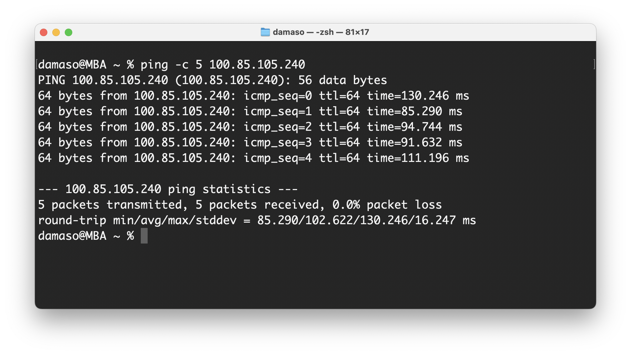

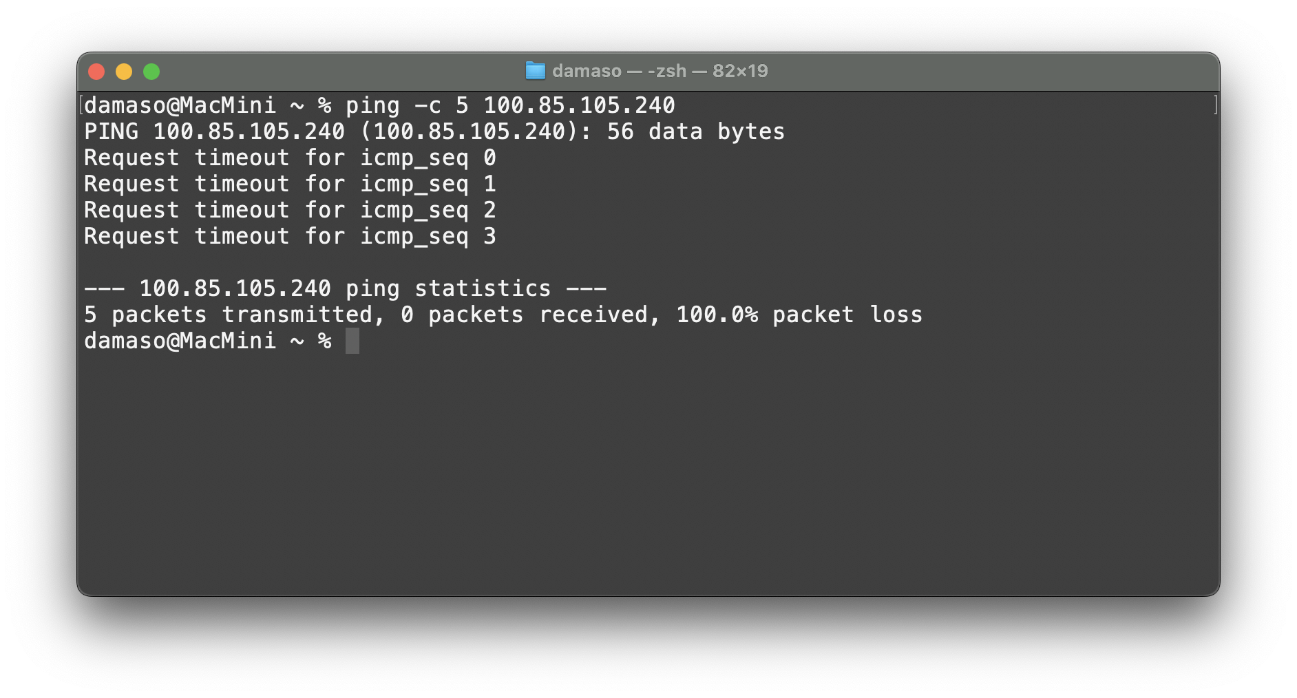

To verify your setup, simply ping the web server from a third-party device outside of the NetBird network using the web server's NetBird-assigned IP:
Terminal No Access to Web Server
There is no response from the host. Now, ping the web server from your configured local machine:
Terminal Access to Web Server
As expected, all packets were transmitted. Now, you can securely SSH into your remote web server from your local peer, either using the NetBird-assigned domain name or IP address:
