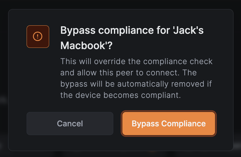

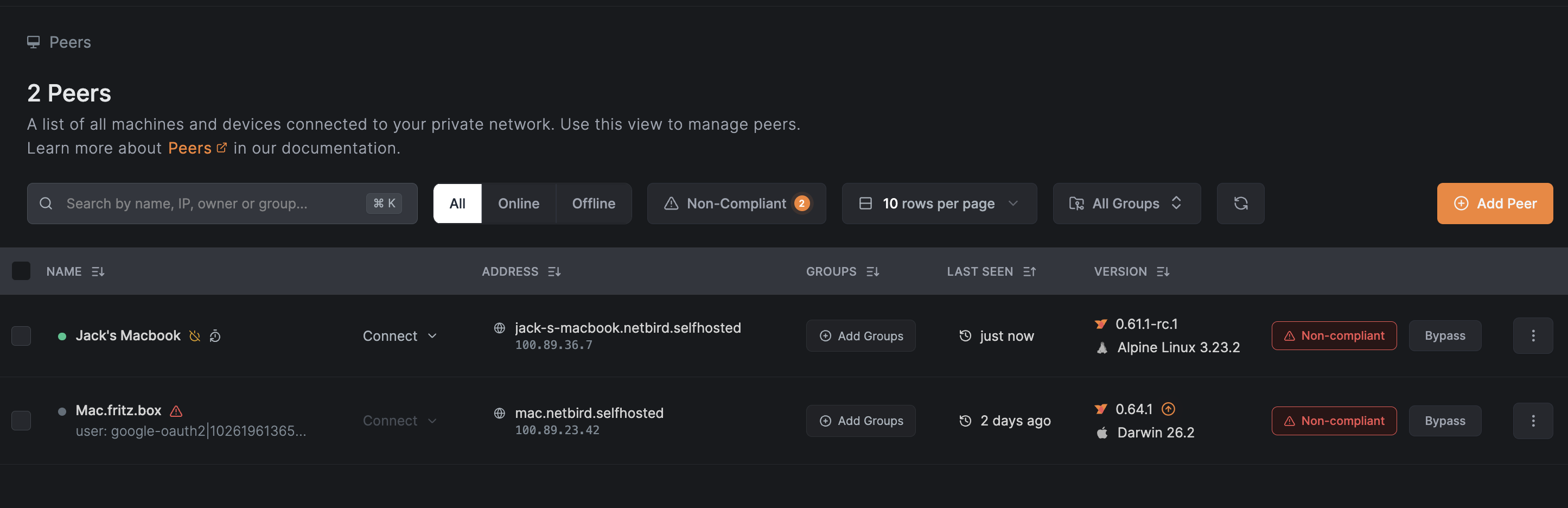

To bypass compliance for a non-compliant peer:
- Navigate to the Peers page in the NetBird dashboard
- Locate the peer showing
Non-compliantstatus (red badge) - Hover over the Bypass button to see which integration's compliance check will be bypassed
- Click the Bypass button and confirm the action in the dialog
The peer will immediately gain network access and the non-compliant status will be replaced with a green Bypassed badge.

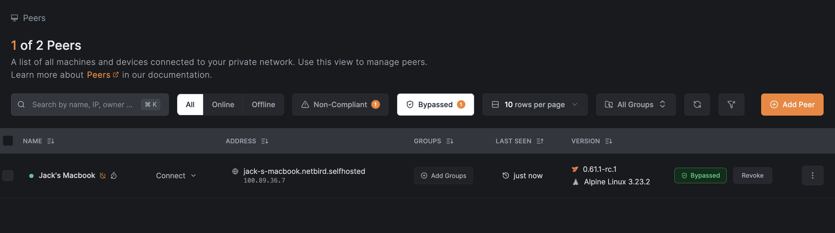

View Bypassed Peers
To see all peers that have compliance bypassed:
- Click the Bypassed filter button (shows a count badge with the number of bypassed peers)
The filter can be combined with connection status filters:
- Click Online + Bypassed to see only online bypassed peers
- Click Offline + Bypassed to see only offline bypassed peers
Hovering over the filter buttons shows helpful tooltips:
- Non-Compliant: "Peers that failed compliance checks and need attention"
- Bypassed: "Peers with compliance checks bypassed by an administrator"

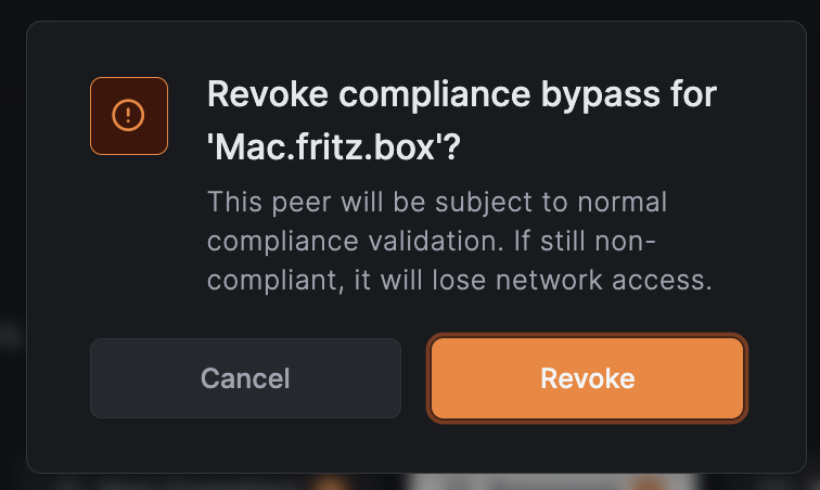

Revoke Compliance Bypass
To revoke a bypass and return a peer to normal compliance validation:
- Click on the peer with bypassed compliance
- Click the Revoke button next to the "Bypassed" badge
- Confirm the action
Once revoked, the peer will be subject to normal compliance checks. If the device is still non-compliant, it will lose network access and show the Non-compliant status again.

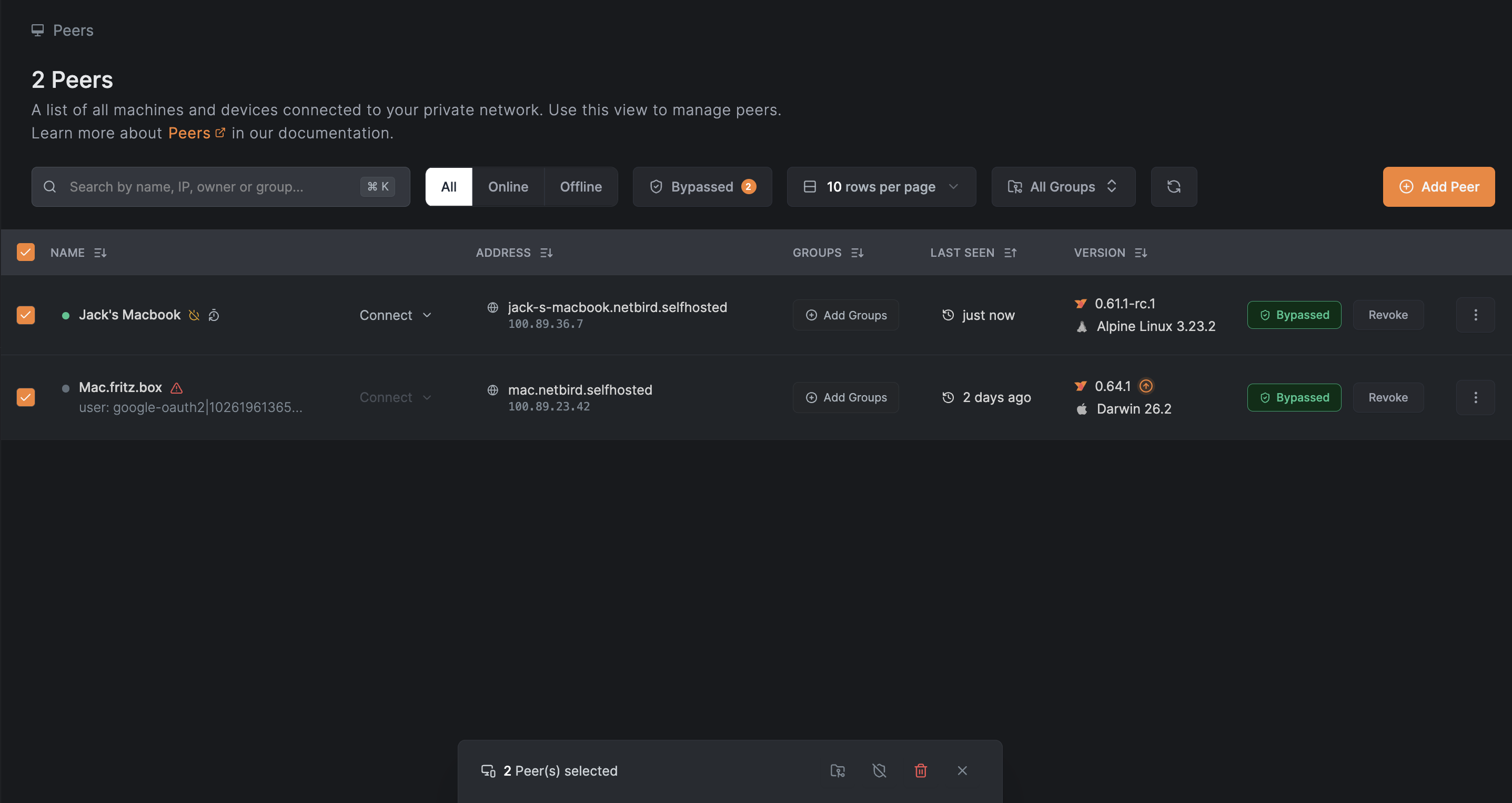

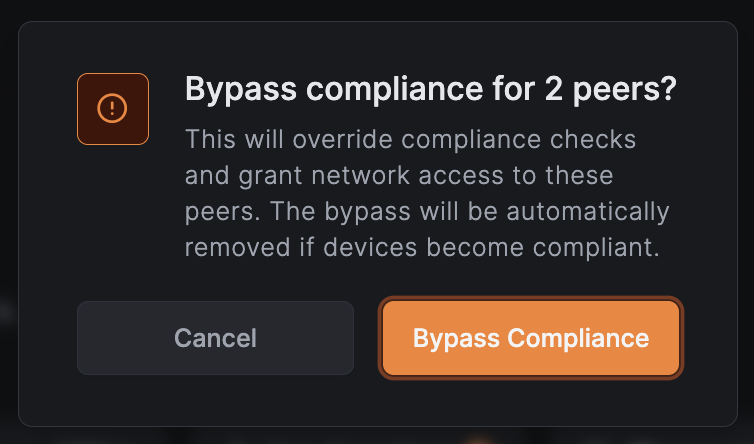

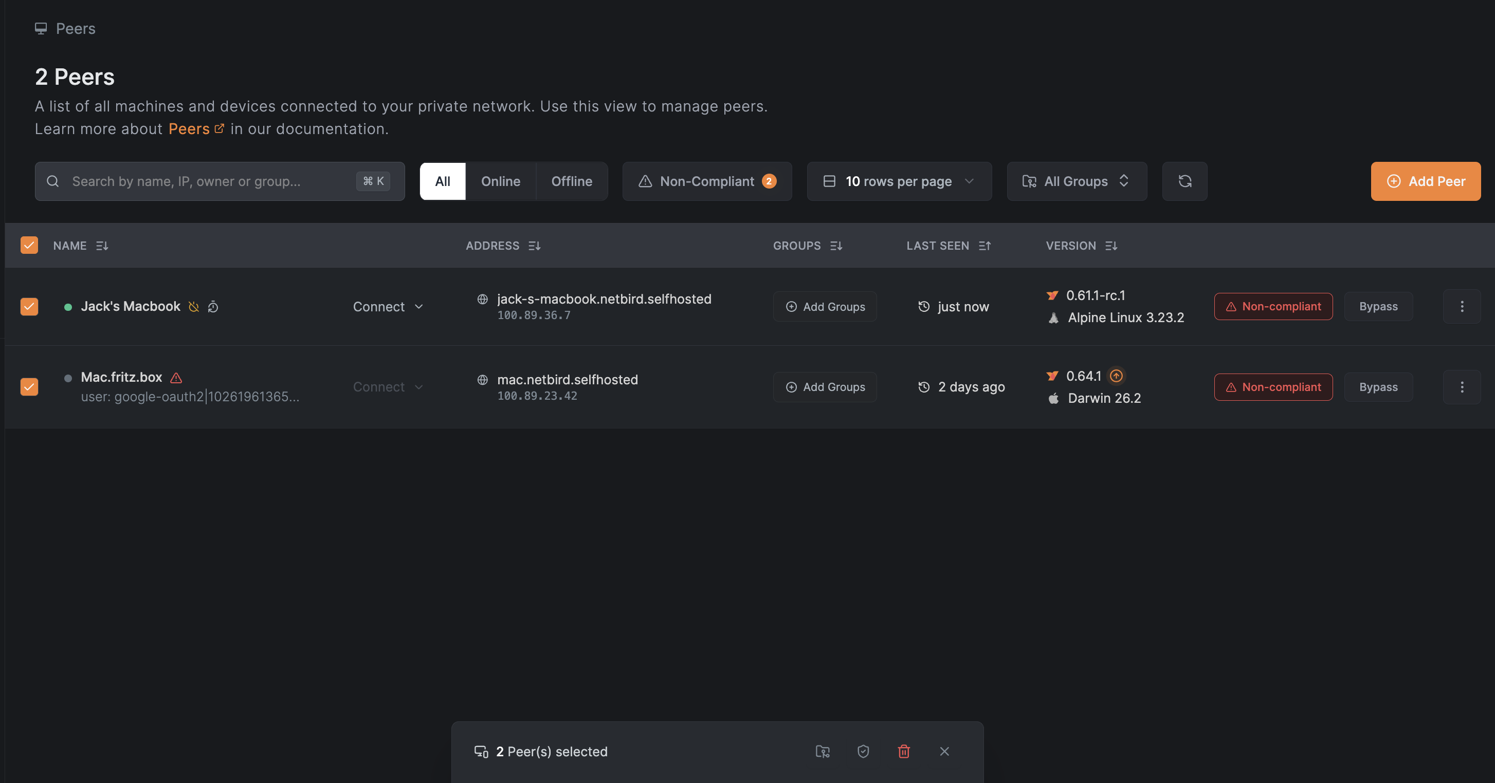

- Select multiple peers using the checkboxes (peers must have non-compliant status)
- In the action bar that appears at the bottom, click the Bypass Compliance button (shield icon)
- Confirm the action in the dialog
The button shows a count of how many selected peers will have compliance bypassed.

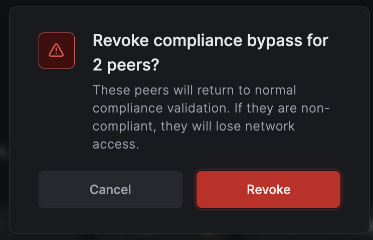

Batch Revoke Bypass
- Select multiple bypassed peers using the checkboxes
- In the action bar that appears at the bottom, click the Revoke Compliance Bypass button (shield-off icon)
