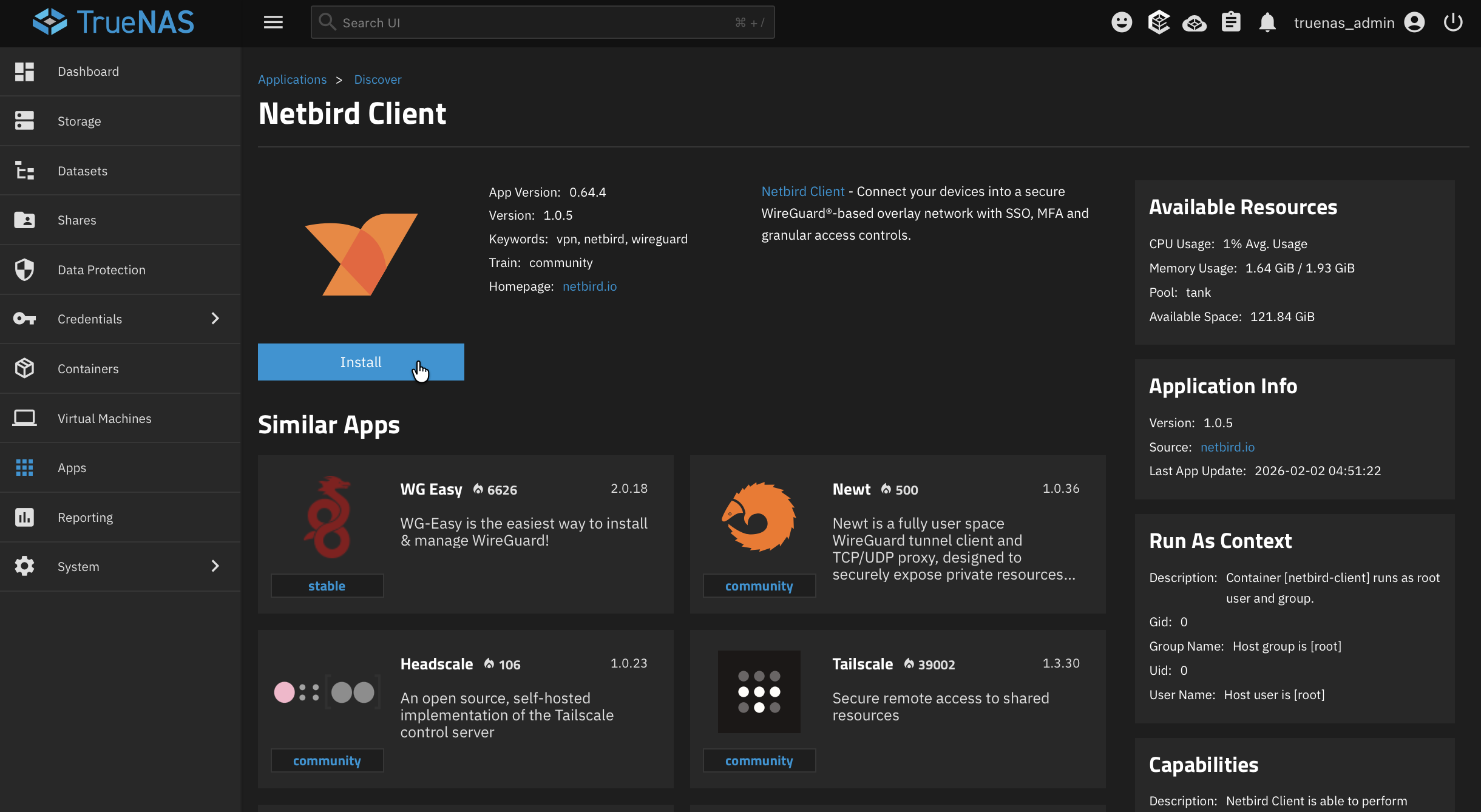

Install NetBird from Catalog

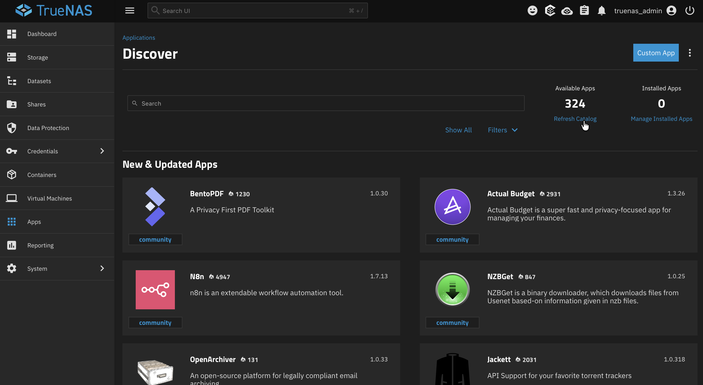

- In TrueNAS, go to Apps and search for NetBird. If it doesn't appear, refresh the catalog (e.g., Discover Apps or the catalog refresh option in your TrueNAS version).
- Click Install and configure the app as described below. Most defaults are fine; the main fields you need to set are Hostname and Setup Key.
- After installation, confirm the app is Running in the Apps list.
- Open your NetBird dashboard and go to Peers → Servers. You should see your TrueNAS peer listed. Rename it (e.g., "TrueNAS" or "NAS") if you like for easier identification.

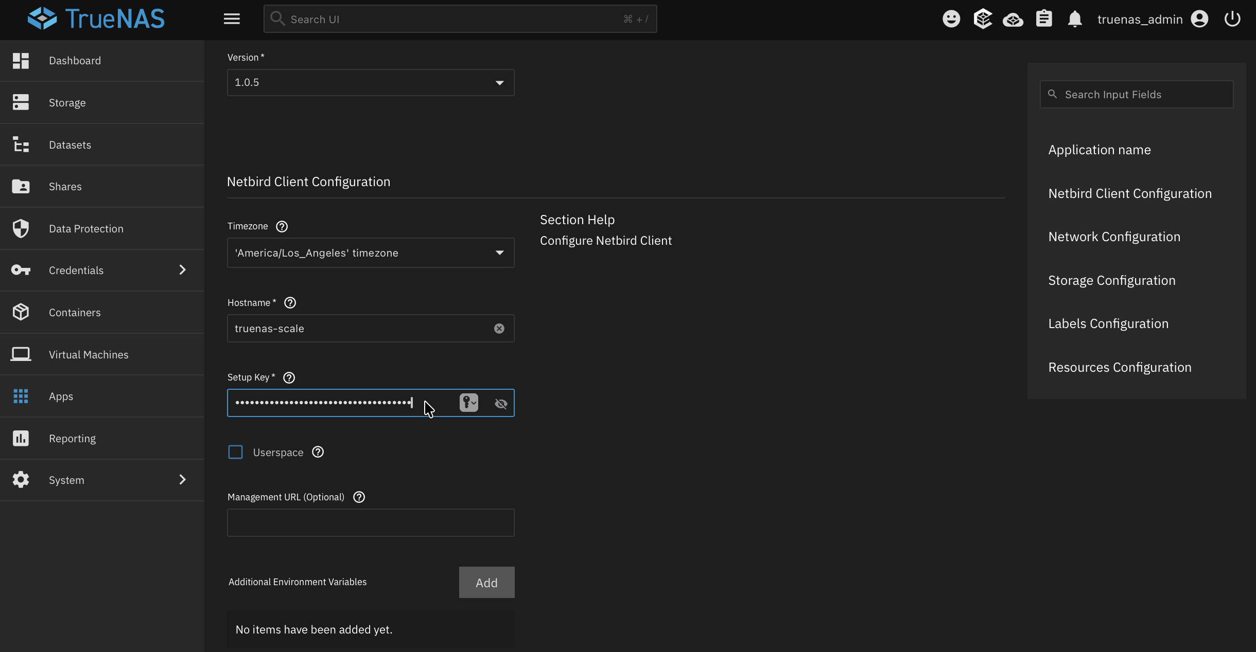

App configuration
When you install the NetBird app, TrueNAS shows an Edit Netbird Client form. Use this as a guide:
Netbird Client Configuration
- Application name: Display name in TrueNAS (e.g., "NetBird" or "Netbird Client"). Default is fine.
- Timezone: Leave default unless you need a specific timezone for logs.
- Hostname: Name this peer will use in NetBird (e.g., "truenas" or "nas"). Pick something you’ll recognize in the dashboard.
- Setup Key (required): Paste a setup key created under
Settings→Setup Keys(see Register machines using setup keys). This registers the TrueNAS peer with your NetBird network. - Userspace: Leave default (userspace networking). Only change if you have a specific need.
- Management URL (optional): Leave empty for NetBird Cloud (
https://api.netbird.io). Set this only if you use a self-hosted management server. - Additional Environment Variables: Leave empty unless you need extra environment variables.
Network Configuration
- Host Network: Enable Host Network so the NetBird container uses the TrueNAS host's network stack. Without it, the container only has its own network and cannot reach your LAN or act as a routing peer.
Storage Configuration
- State Storage: Use the default (e.g., ixVolume) so NetBird can persist its state. This keeps the peer identity and config across app restarts.
Resources Configuration
- CPUs and Memory (MB): Defaults are usually sufficient. Increase if you have many peers or heavy routing.
You can leave Labels and Additional Storage empty unless you use them for access policies or custom storage.
