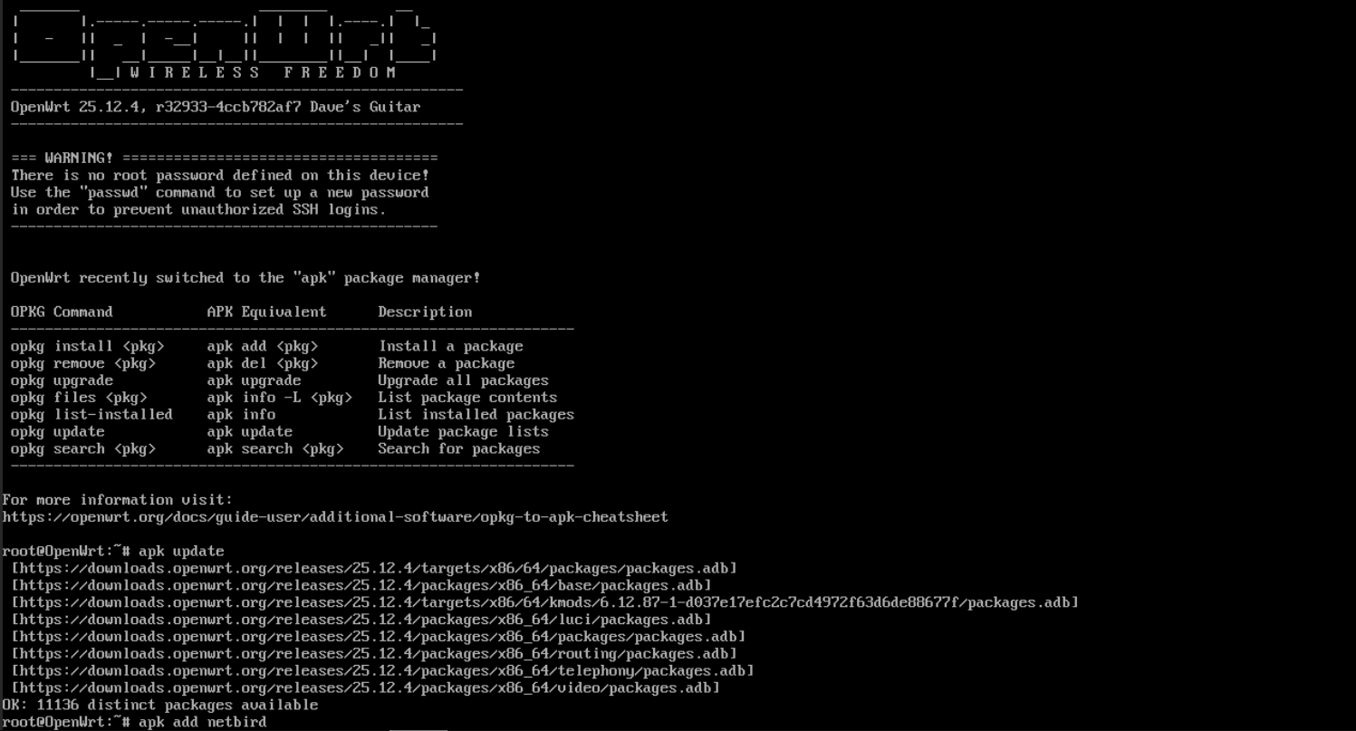

Install the NetBird package
On OpenWrt
24.10and earlier:opkg update opkg install netbirdOn OpenWrt
25.12and later:apk update apk add netbird

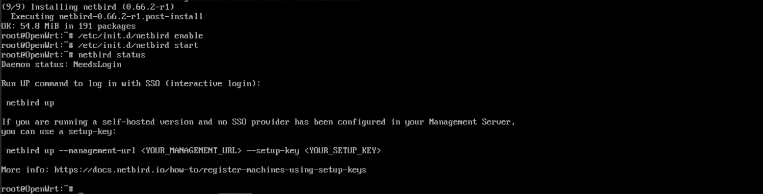

Enable and start the NetBird service
The package installs a procd init script at
/etc/init.d/netbird:/etc/init.d/netbird enable /etc/init.d/netbird start

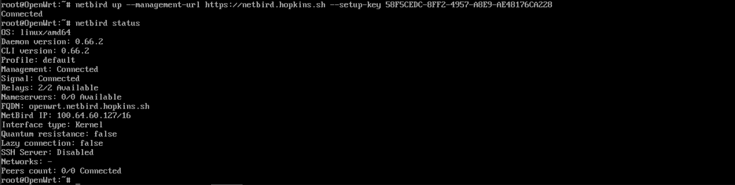

Connect the router to your NetBird network
Authenticate with a setup key:
netbird up --setup-key <SETUP_KEY>
If you are self-hosting NetBird, point the client to your management server:
netbird up --setup-key <SETUP_KEY> --management-url https://netbird.example.com:443
Verify the connection:
netbird status -d
