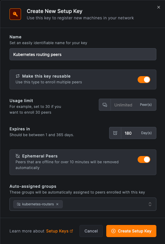

Step 1: Create a setup key
Navigate to Settings → Setup Keys in the NetBird management dashboard and click on "Create setup key".
Choose a name, e.g. Kubernetes routing peers, mark the key as reusable and enable Ephemeral peers. This option is ideal for stateless workloads like containers, where peers that are offline for over 10 minutes are automatically removed.
Create or add group called kubernetes-routers to the Auto-assigned groups list. This designation can be adjusted to suit your needs.
See the screenshot below for reference:
k8s-create-setup-key
With your setup key created, note it down for the next steps.

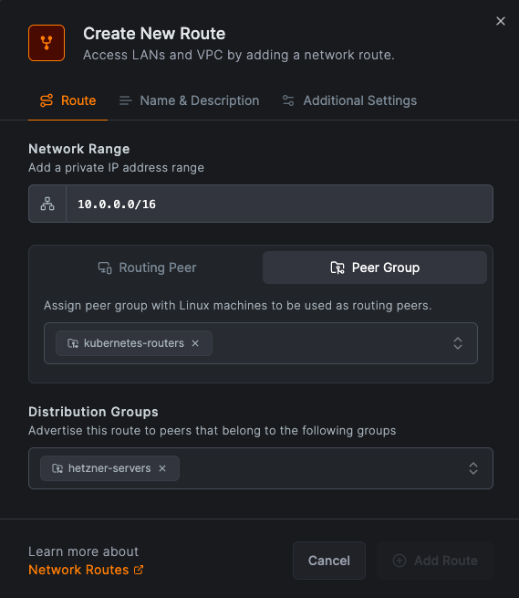

Step 2: Add a network route
Navigate to Network Routing → Routes in the NetBird management dashboard and click on Add Route.
Set your kubernetes pod range as the destination network, and select the Peer group option, choosing the "kubernetes-routers" group. This configuration allows for scaling pods as necessary within your Kubernetes cluster.
Set the distribution group to hetzner-servers. This group is used to distribute the route to all servers in the group.
k8s-add-network-route

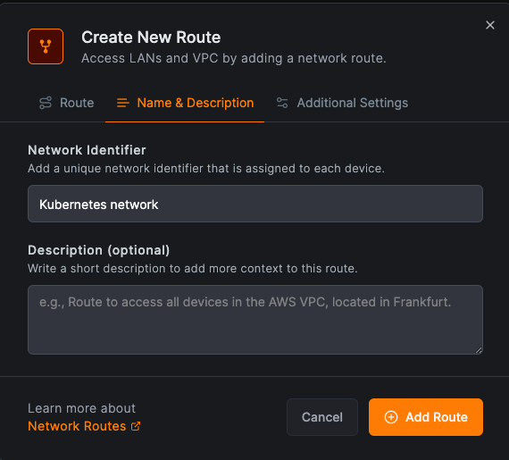

Click on Name & Description to give your route a name and description. Then click on Add Route to save your changes.

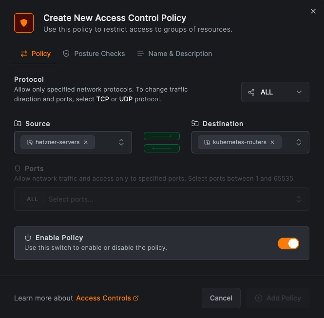

Step 3: Create an access control policy
Navigate to Access Control Policies in the NetBird management dashboard and click on Add Policy.
Set the source group to hetzner-servers and the destination group to kubernetes-routers. This configuration allows the Hetzner servers to access the kubernetes pods.
k8s-add-access-control-policy

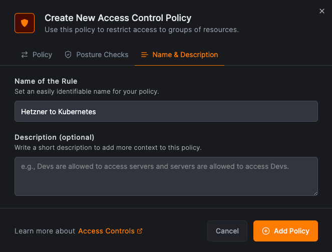

Click on Name & Description to give your policy a name and description. Then click on Add Policy to save your changes.

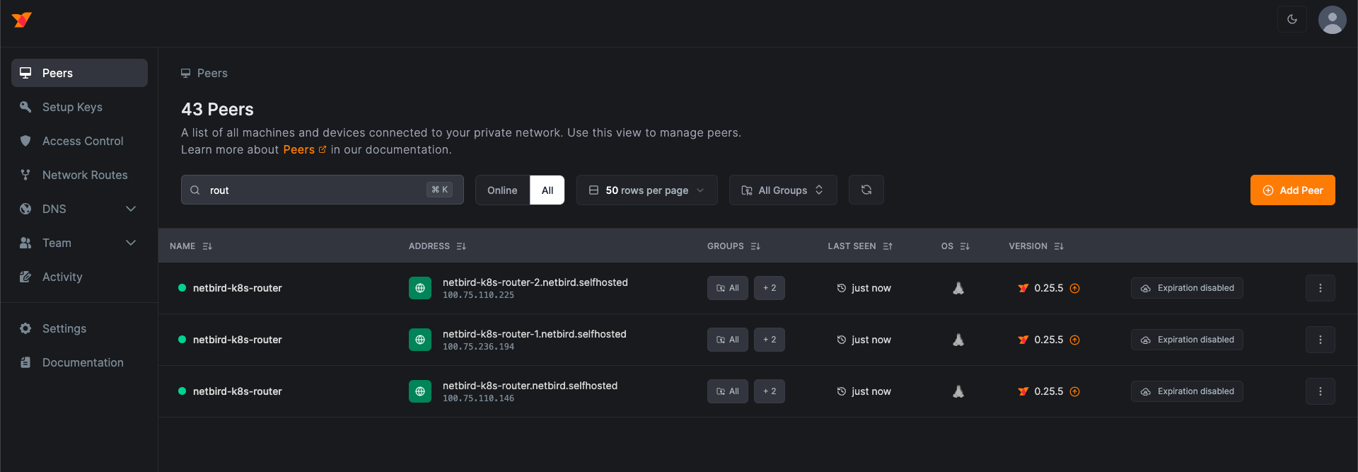

Step 6: Verify the deployment
After deploying the NetBird client, you can verify that the client is running by checking the logs of the pods.
kubectl logs -l app=netbird
You can also verify that the client is connected to the NetBird management dashboard by checking the dashboard.
NetBird client pod shown as connected in the dashboard
