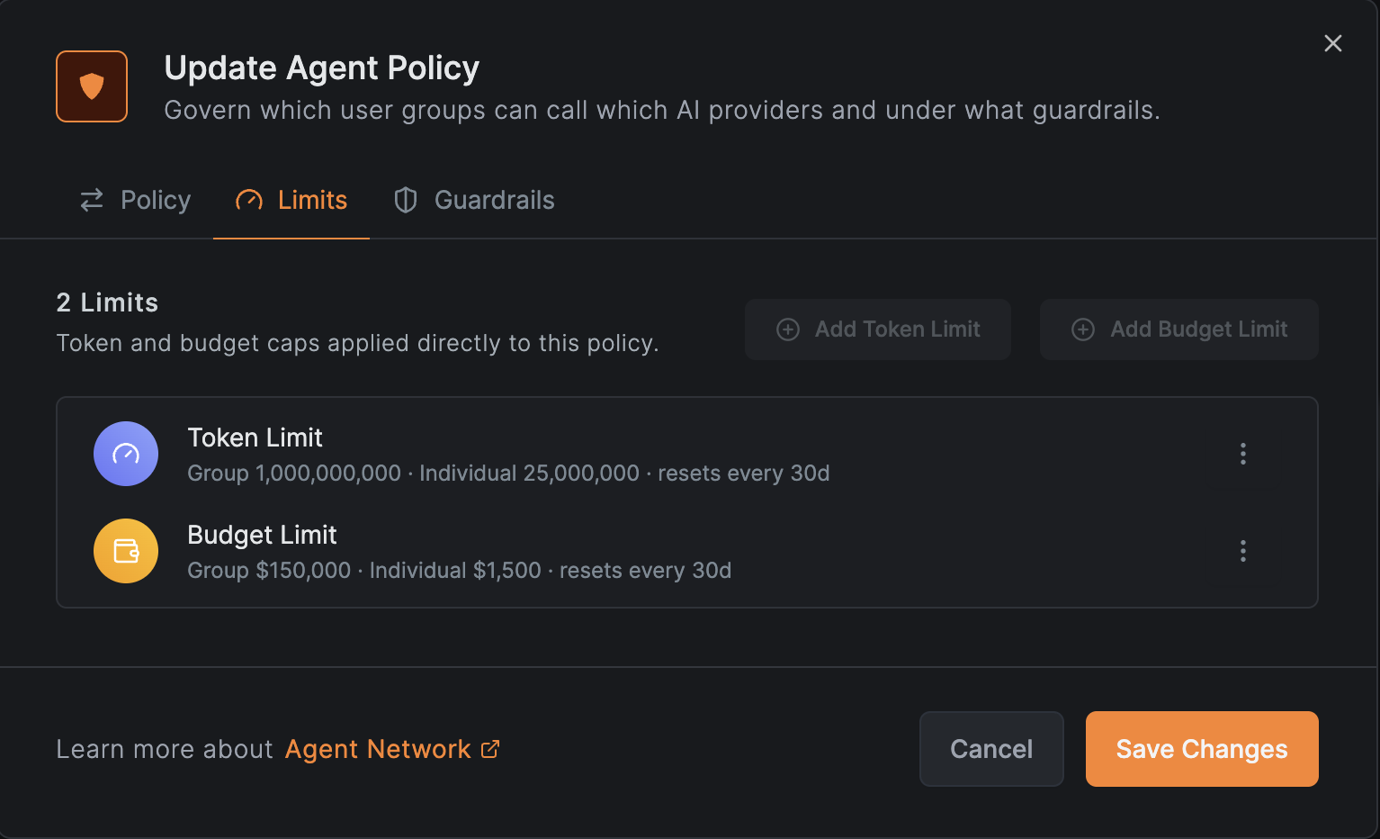

agent network token and budget limits on a policy
To enable limits, open the policy's Limits tab when creating or editing a policy, turn on the token and/or budget limit, and set the per-user and per-group caps and window.
